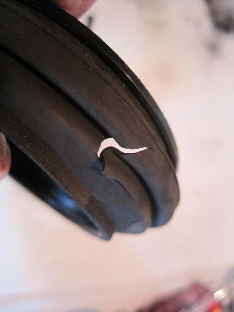

    Pictures from last weekends projects
    Caliper disassembled
    Piston cleaned up
    Old outer seal that was torn
    All the old rubber bits removed
    Speed bleeder installed
    Solid brake guides and everything put back together
    Everything put back together. You can see the new control arm in the background as well as the new brake line.
