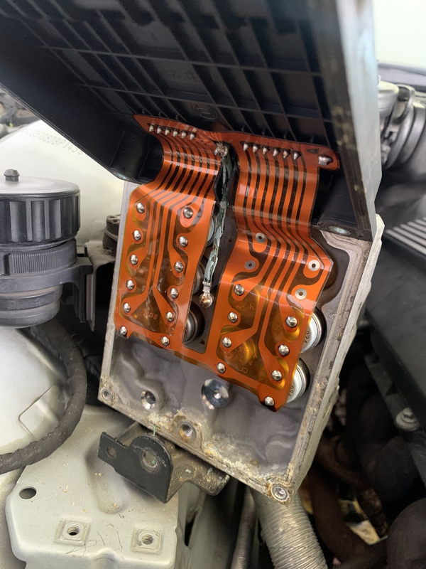

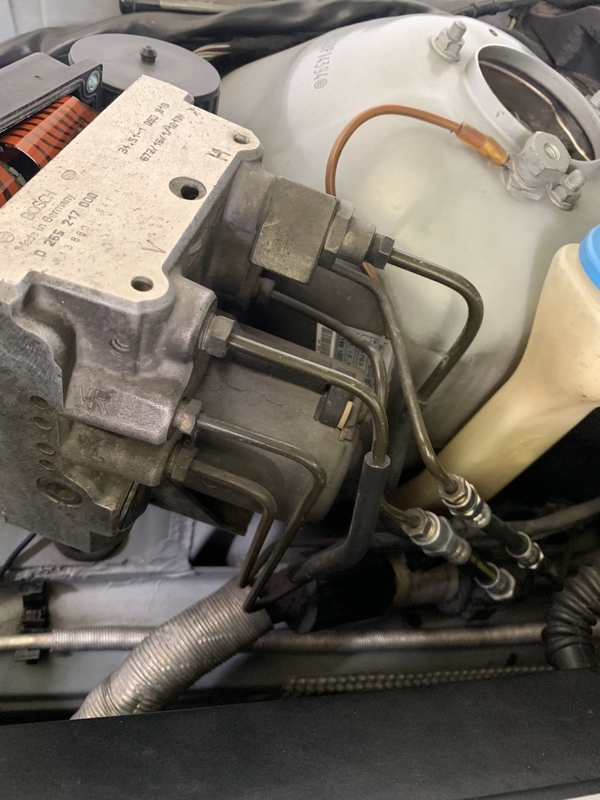

    I checked everything again and I think I've isolated the problem to a partially stuck ABS module valve/solenoid, very similar to this:
    https://www.youtube.com/watch?v=Dh82Ohnl9IE
    I see the hydraulic part is non-serviceable so I'll try getting it unstuck with magnets, compressed air and some mild lubricant. If that doesn't work then I'll try a torch. Since it's not completely stuck I think I have good chances of freeing it up. I suspect after the main cylinder replacement, some dirt from the old one found its way there and caused the issue. The good news is that since my car is so old, the ABS electronics are under the dash so the module is mostly mechanical bits.
    Resident Third World Country Advisor
    Costa Rica
    6,382
    Blown 528i, KE30, Pathy
    In case you have never seen one of those very early, electronic-less modules (also found in E36/E38s). It looks like BMW always thought "hey, that thing is very close to the exhaust, better put those electronics elsewhere" but then around 98/99 they said "hold my warm beer".
    The valves in these ones are probably serviceable, but the idea is not to desolder anything. I'm using a strong magnet to hear for those clicks and try to loosen up any dirt that could be lodged in there. I'll probably get a used module if that doesn't work and I'll further tinker with the worst one.

    It may not be the valve or solenoid, but that thin ribbon connections causing bad connections. See here, this is for e36:
    http://www.staffordnet.net/repairs/bmw/abs_pump_rewire.htm?i=1
    http://raysaywhat.blogspot.com/2014/...8-bmw-e36.html
    Not exactly the same design but may be worth checking as a root cause.
    Costa Rica
    6,382
    Thanks. From what I've read, these modules are relatively bulletproof. I tested and cleaned the connections and it all seems fine. There is a ground wire in the middle which can be seen in the first pic, the insulation was completely gone so I also fixed that just in case as well as RTV-ing the long gone weathersealing. I am hoping that lightly tapping on the solenoids and the magnet trick had some effect. I will need to go out and drive it. If not then the next step would be to completely remove the module from the car and bench test it using compressed air. I am avoiding that mess until I've exhausted other methods. I can see those modules are very cheap on eBay, probably because they lack the electronics, so I won't waste too much time troubleshooting this one. If I end up replacing it, I will take the bad one apart for sure. There's a surprising lack of information about these early modules. These may even have their own bleeder screws, negating the need for a scanner to cycle the valves. Not sure about that but I'll find out if I can.
    The module became the primary suspect after I took both front calipers off again to see if there were some signs of sticking, I bled the system for the n-th time and noticed that the front left corner was bleeding at a slower rate. Unnoticeable unless you are really looking for it. Most people who have stuck solenoids have completely dry lines and rusty rotors. I didn't. The module is basically acting like a swollen rubber brake hose. It all makes a ton of sense now. It still could be something else blocking the flow of fluid downstream, but I'm betting I found the culprit.
