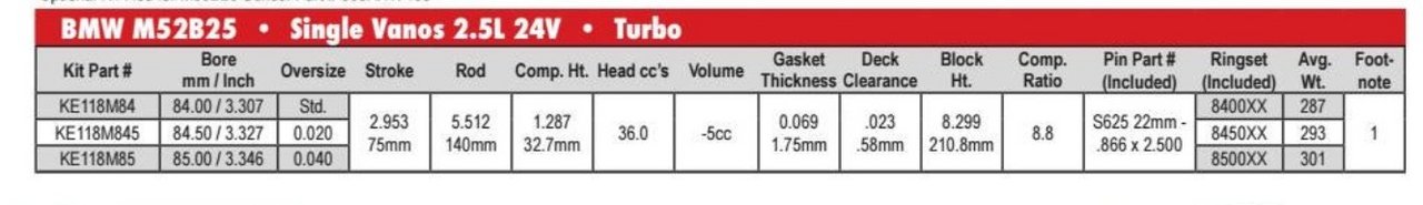

    Assuming these are KE118M845 right? Note that the specs in the wiseco catalog are wrong, the combustion chamber volume is actually 34cc and the deck height is actually 210mm
    86 325es, 2.8L m50, S476sxe, ProEFI 128 ecu, e85, solid rear axle, TH400 trans, 28x10.5w slicks, zip ties, popsicle sticks, tape
    best time 9.06 @ 151.8 mph, best 60 foot 1.30
    Oct 2021
    Germany
    30
    1996 320is
    Hey Perry, thank you for that!
    My pistons are actually WKE315M845, I suspect Wiseco is using a different part number system over here?
    See yourself:
    1,3070" compression height = 33,2mm
    So, if I put in the numbers, I also end up with ~9.3:1, am I using this right?

    I could lower the CR with a 2.0mm cutring gasket instead of the 1.75mm and would be ending up at like 9.1 CR, if I put in everything right and I THINK that would be totally fine for my goals and type of fuel.

    Yes that looks correct.
