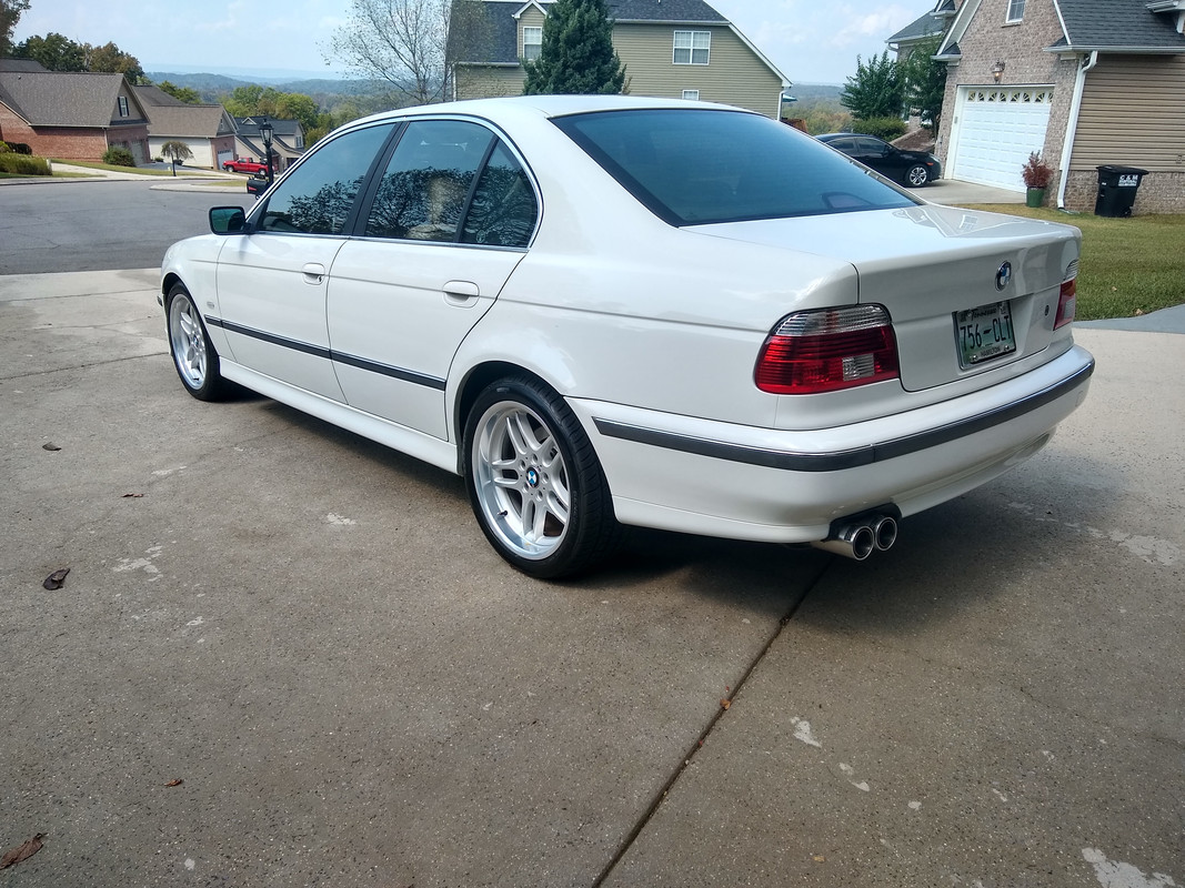

I did some searching and found no conclusive info.
Please, I don't need coments such as why not buy E39 with M62 etc...I've had 98 540 and 03 M5. I liked both cars a lot but strangely I find myself enjoying my 528 more because of superior rack and pinion steering feel combined with lighter aluminum subframe.
As most here know S52 is close cousin of my M52 with different bore, stroke and camshafts. Also, they use very similar DME and my understaning is that there are companies out there who can reflash my DME to work with S52 and eliminate EWS.
Also, I'm aware that I need different driveshaft and the factory diff on my 528 is 4.10 and 2.93 diff is matched with 5 speed manual. But since E39 is heavier maybe 3.46 diff would be the best of both worlds.
I've also thought about buying 01-03 530i 5 speed but those are very rare and I love my 528 with Bilstein B6, refreshed suspension, upgraded front brakes to 530i/540 size, brand new OEM M Pars and recently swaped black interior (almost there) instead of ugly sand beige factory one.
To me, 50 HP / 33 lb-ft bump along with manual instead of 4 speed automatic is enough reason to do this.
What say you masses?
