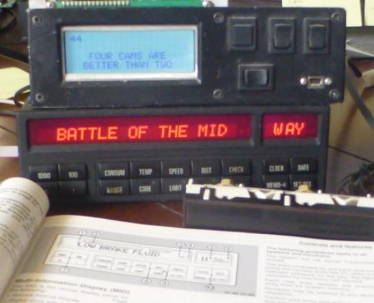

    It was decided to pull Hyperdrive-MID out of a 5-year sleep so as to evolve an ETV output device that is brighter and doesn't sacrifice the radio slot.
    MID rev A was actually in great shape and is now behaving very MID'y, shown below driving E36 OBC glass.
    A thread will be posted someday. >> Done: "Battle of the MID way".
    It's actually the same code base across all Hyperdrive boxes, so developing MID also develops the same capabilities in ETV.
    Things like code download, parameter editing, data logging.
    ETV outputs to Ibus, and therefore H-MID can now display ETV stuff within the service menu and by exercising stalk options.
    After MID is further squared away, adding Bluetooth, then back to ETV specific features like PID algorithms, to operate the vanos.
    ETV competes with a (codename CEFIG) ecm for priority, as MID also unsticks that project.
    Character display during swap dev.
    Displaces radio, hard to read in sunlight.

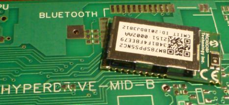

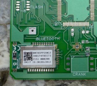

    Well, it was meant to show up in rev B, but long-short something got seriously messed up.
    As was on rev B, the local processor and modem were in mortal combat.
    Basically, I was assuming the Bluetooth modem was a slave to the local processor, but it was actually an extension of the over-the-air (Windows) host.
    This was GoodNews-BadNews.
    GoodNews because, as long as Hyper-MID (revC) decides to get out of the way and treat the modem as and extension of the host, INPA is free to do whatever it does.
