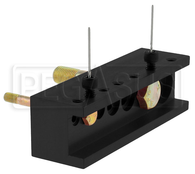

    If you'd like to make your own drilled head bolts, I'd recommend buying one of these:
    or these:
    But if you want to do it the hard way, all you need are these few items
    - Drill press vice ($12 HF)
    - 1/16th" cobalt drill bit, buy more than one
    - Oil to lubricate the drill
    - Drill press (handheld would be incredibly difficult)
    - good dikes
    - good needle nose pliers
    - flat head screwdriver
    - SAFETY GLASSES

    Thread locked, torqued and safety wired the ankerman arms
