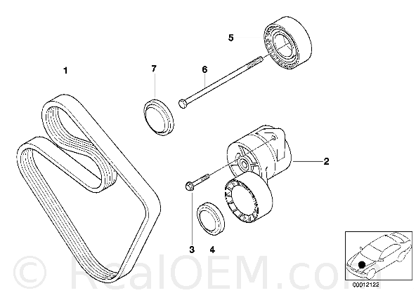

    Which pulleys would you replace while replacing the fan clutch?
    On an E39 530i 120k.
    If you already have the fan off, what else could be easily replaced while in there?

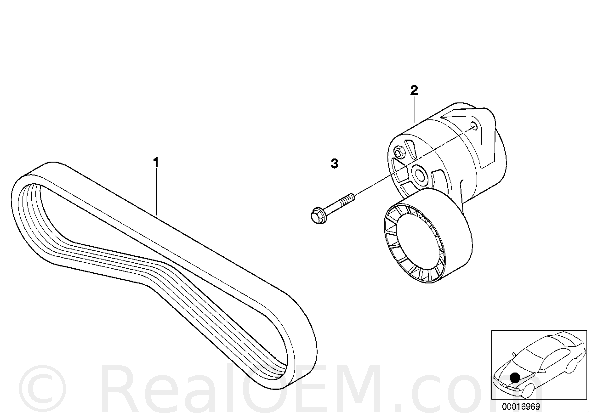

    I'm pretty sure I have mechanical tensioner, b/c I've seen the "bolt" you put the socket onto to loosen the belts.
    So, I only need to get 2 parts from the 2nd diagram, correct?
    UPDATE: I ordered the following:
    #5 in the 2nd diagram (11287841228)
    Deflection Pulley
    #2 in the 2nd diagram (11281427252)
    Mechanical Belt Tensioner
    Is that all?
    Bottom line, what would you replace here? http://www.realoem.com/bmw/partgrp.d...587&hg=11#1118
    Do people bother changing the AC tensioner as well?
    No one seems to mention that one, but one would think that fails just as often.
    Is it b/c if that pully/belt breaks, the only consequence is not having A/C?

    Waterpump, thermostat, belts, and all the plastic pulleys.

    Quote Originally Posted by zarbat007 View Post
    Deflection Pulley
    Can someone verify this?

    Quote Originally Posted by OnTheFence
    Well, I would because of my experience with my old e32. Changed one tensioner only to have the other fail within a couple weeks so I had to do the same job twice. Replace all tensioners and do the job once imho...
