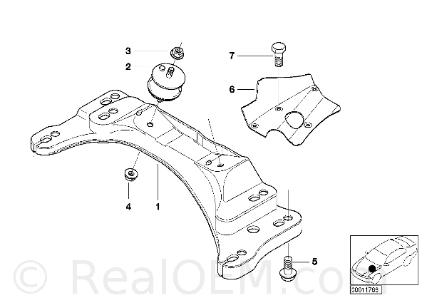

How about the transmission mounts? Part #2 in the diagram below.
He does think that either of those is at fault. I wondered too, that the shaft would have to get off-center (a lot) to hit another piece of metal down there-right? Unless, as you suggest the center piece id loose. We'll see...
I am not familiar with the underneath of the car at all but will ask him to keep it up there until I pick it up..
As for you idea about the transmission mounts, the noise is more towards the center of the car. When I drive slowly, it sounds like it comes from the back. But when I make it clunk with engine off (see above), the noise sounds dead center under car, not forward....but i will keep you posted.
