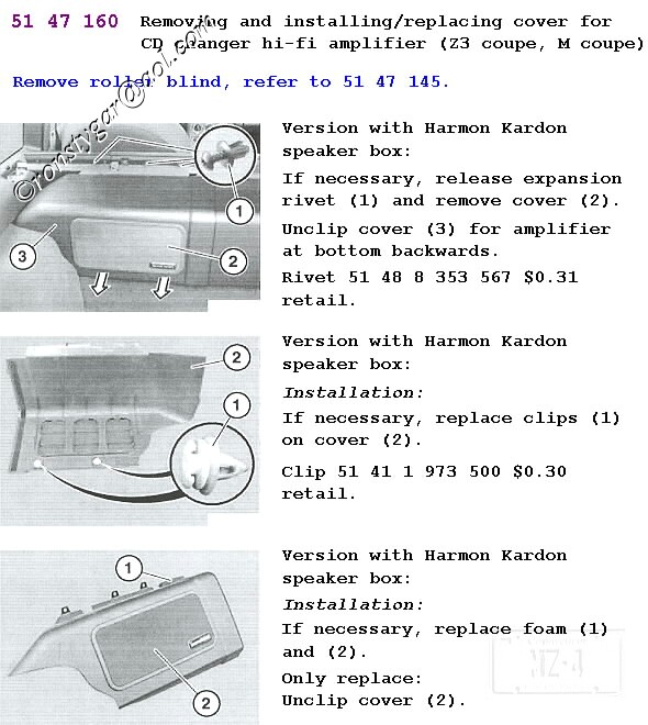

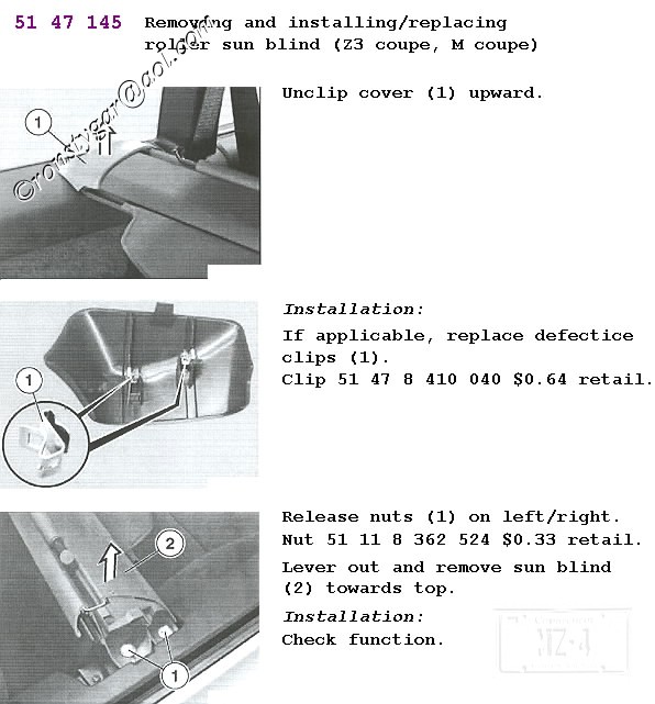

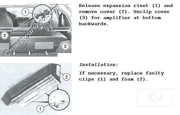

    You'll need to take apart the rear hatch area. I've taken it all apart to install my amplifier back there. Pictures courtesy of Ron Stygar.
    1) Remove the tonneau roller/sun blind:
    http://www.unofficialbmw.com/images/...3c-5147145.jpg

    http://www.unofficialbmw.com/images/...-5147160-1.jpg
    3) Remove the amplifier cover:
    http://www.unofficialbmw.com/images/...-5147160-2.jpg

    1) Pull out the black snap on plastic pieces on the sides of the tonneau roller/sun blind: http://www.unofficialbmw.com/images/...3c-5147145.jpg
    2) Next use the 10mm socket wrench and pull out the nuts and remove the tonneau roller/sun blind.

    3) Pull out all the expansion rivets and using the mini screwdriver kit.
    4) This will allow you to pull out the plastic covering over the subwoofer (left side) and the amplifier/cd-changer space (right side) and allow for exposure.
