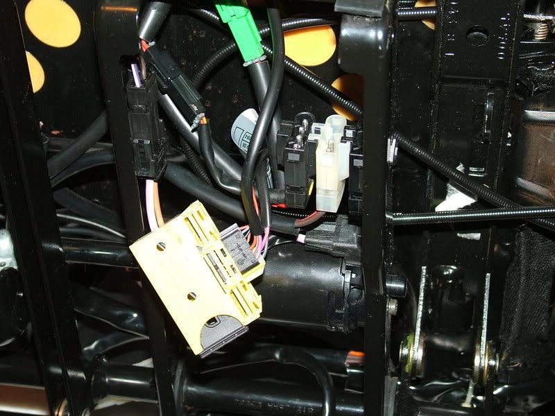

    Tilt the seatback rearward as far as possible--this will allow better leverege for working under the seat, and also easier removal from the car. lift the back of the seat forward toward the windshield and get in behind it with lighting so you can see where the connection from the floor meets the seat connection. It is a yellow and black boxlike plastic structure that is fastened to the seat bottom. You can twist it to unfasten it from the seat. Once it's unfastened, the wiring can be disconnected by pulling on the black plastic piece on the side labelled 'a' in this image (The connection is shown already disconnected):

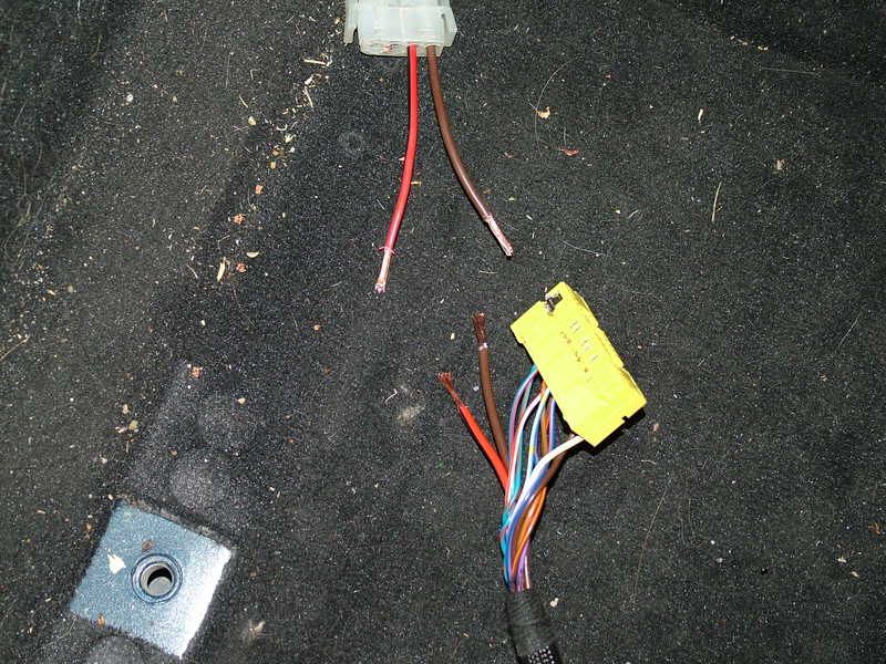

    Here is an image of the connection that comes out of the floor (already disconnected):

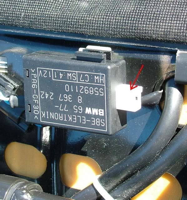

    Look at the underside of the replacement seat and you'll see the "seat occupancy sensor" which is shown in the following image. This needs to be connected in order for the seatbelt tensioner to fire and passenger side airbag (if equipped) to go off in event of an accident. The airbag indicator lamp will light up on your instrument panel if this is not connected when the battery power is restored. You will then have to pay for either the reset tool or a trip to the dealer to reset it. The driver's side doesn't have the occupancy sensor--the car assumes there is a driver present in the event of a crash. This image shows it disconnected--a white plug inserts where the arrow is:

    On both replacement seats you'll see connections like the following:
    The black plug is for the heating feature, and the white plug is for the seat motors. Because I had bought a separate wiring harness, I was able to salvage the parts that plug into these and make the following connection using butt-connectors (you can use blade connectors, wire nuts, or solder if you prefer). If you use butt-connectors, gentle pulling will ensure that you've crimped them sufficiently.
    As I hope you can see, I only cut and rewired what was necessary to make the circuits complete. Some of the wiring from the old seats was compatible with the wiring in the yellow floor connector, and I plugged those seat wires right into the yellow seat-side connector as shown is this image (the central three blocks of wiring in the connector):
    The outside blocks of wiring--one at each end--are what were converted to the old style plugs.
