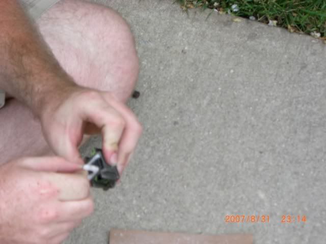

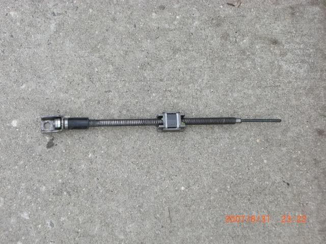

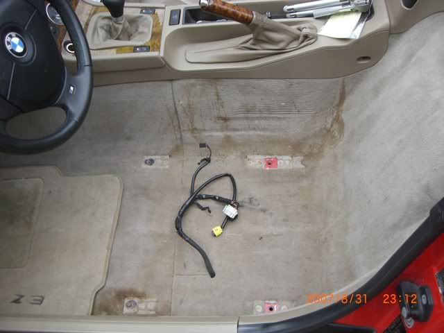

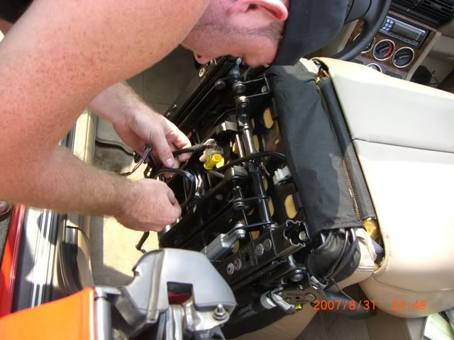

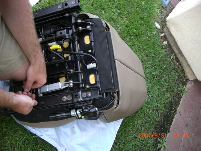

    did it in a parking lot of a hotel at home coming last year.

    Great! Thanks for the photos.
    Just finished ordering the new bushings. Looks like a pretty straightforward repair.
