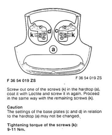

    Good stuff, and I've got one for anyone with Roadster hardtops that have experienced a "flexing" noise when going over speed bumps, incline turns or just any crappy roads. Not a rattle per se, but rather a flex squeak from the fiberglass hardtop. Check your hidden base plate screws. They get loose over time and it's impossible to notice due to the base plate covers.
    You can do all the standard fitting adjustments as per the BMW document, but the adjustment outlined above should be checked over time. I neglected this one until recently, and it completely eliminated any flexing noise.
    Turn your rear hardtop handles halfway open to allow some "give" for the front adjustments.
    Remove the plastic base plate covers on the front left and right of the hardtop (by pushing them away from you) to expose the three torx screws. If the screws are secure, then you are most likely fine. I noticed play in several on each side, hence the adjustment.
    Loosen the three torx screws on each side and then use good light or a flashlight to make certain your primary hardtop attachment screws are going straight into their housings - not at an angle. Move the base housings as necessary until the primary torx screws lock in without issue.
    Screw the primary single screws on the left and right a few turns to get them fully seated. Then tighten the three torx screws on the plate assembly until very tight. You can also use a bit of loctite on one or more of the three screws as per BMW above, but I did not, as I might sell the top at some point and want the buyer to be able to adjust them as per his car.
    Lock down the rear hardtop latches fully. Now tighten the two primary screws on each side, double-check the three torx screws and replace the base plate covers on each side.
    No more hardtop "flex" noise...
