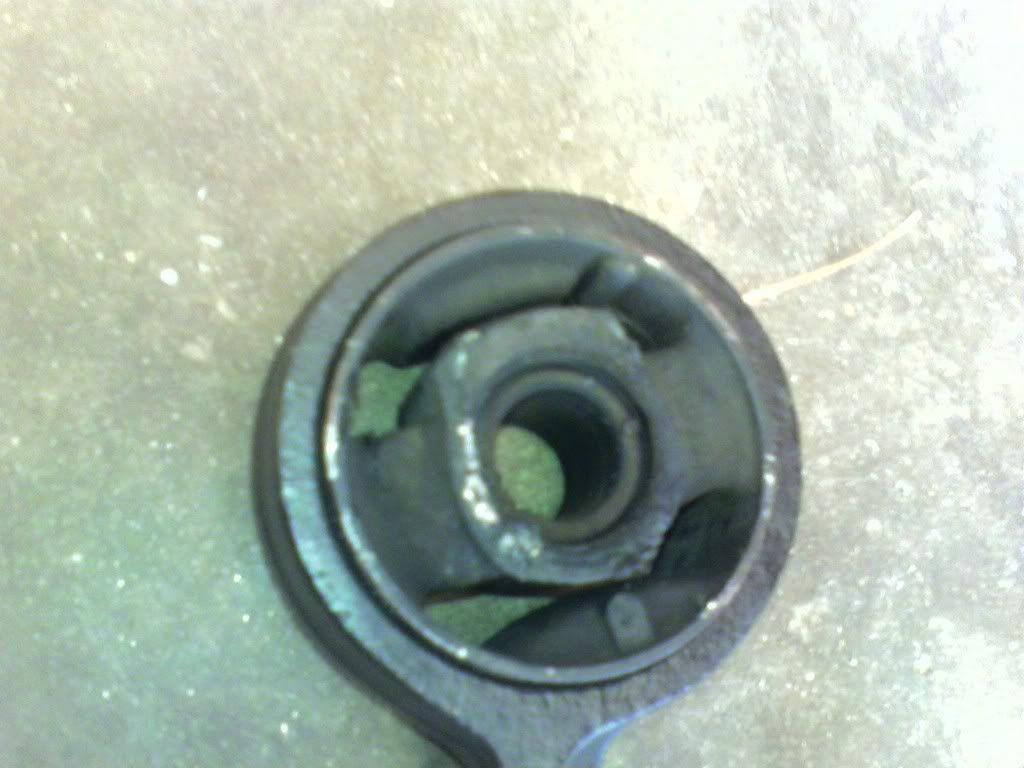

    With the bracket and bushing now out of the car i proceed to remove the center of the bushing, this was not essental i just wanted to see how easy it was. It took one hit with a dead blow hammer to remove the whole center (pic below.)

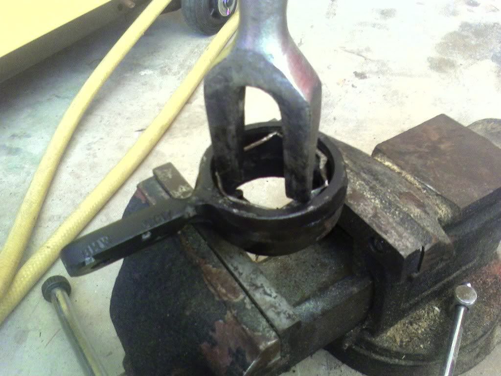

    Now using the ball joint fork again i beat the metal shell of the bushing out of the holder: (pic)

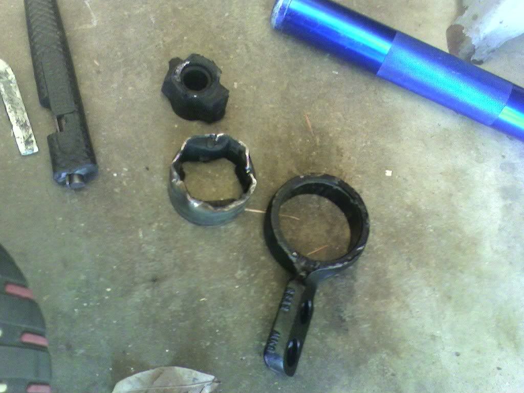

    The end result is this:

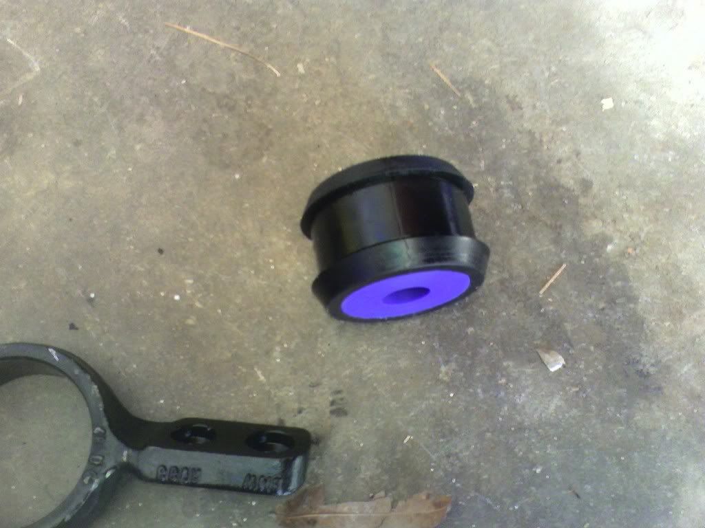

    The new bushings from power flex are really really kwel. they are a two piece design that locks together as well as around the bracket. the middle of the bushing is made to pivit with suspension travel with out letting it felx left right or up and down. you lube the center section and use sand paper on the control arm and the bracket to make sure that the two pieces of the bushiner stick to their contact and it only pivits in the proper place.
    Pic of new bushings.

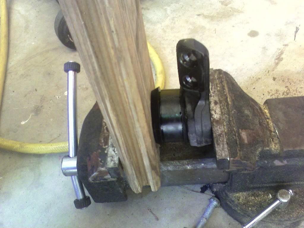

    I used a piece of wood and a vise to install the new bushings into the brackets, it was painless.
