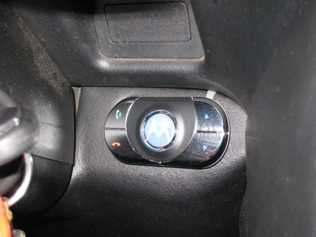

The phone kit comes with a speaker but also has wires so you can put it into your phone capable radio. I solder the wires to the pins supplied by Becker.
Removed the screw here to allow some space to run the wire through for the control unit. It's being held by double sided tape.

I've had the Motorola IHF-1000 (with my Razr) and Navone Engineering iPod kit installed in my car for over a year now and it works flawslessly. The phone kit lacks a charging port (not a big deal) and doesn't use the car's built-in mobile phone signal booster (Coupe-only IIRC). Still, it works as well in practice as my previous two Motorola phones (v60 and v710). For those two previous phones, I used a different Moto kit which utilized the booster and had a docking station to charge the handset.
The IFH-1000 is vastly superior to any other kit I've seen. As Phil mentioned, it does have noise cancelling technology but, in addition, has caller ID, voice dialing, its own phone book along with many other things I can't remember. When I did my install, I removed the centre console, glove box, drivers side lower dash and passenger side kick panel. Laying out wires was easier this way and I used the x400 connector already in place in the car to make it 100% reversible.
