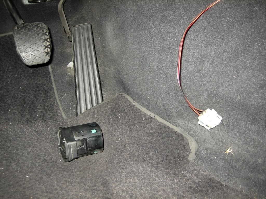

    Alright, so i wanted to ground the switch to fix it.
    I took out all the covers and and the metal plate to expose everything. You then need to unplug the yellow harness
    Notice the car won't start now. The harness has 3 wires, one power wire and 2 grounds. One of the grounds is to start the car and the other for changing gears while driving. You want to ground the starting ground.
    So with a multimeter, I figured out which one is the one to start the car, and crimped both wires together. You're just connecting these 2 wires together to ground it and make it "always on"
    After you connect the wires together, make sure everything is nice and tight.
    DO NOT plug the harness back in, just leave it out.
    It'll look like this
    Start the car to make sure everything works. Then put everything back together.
    Now go for a test drive, you will notice your RPM doesn't hang when you hit the clutch, it goes down right away. Now the ride will be nice and smooth.

    came across this post after someone on the e36 forum was searching for a solution to this problem. I have a question or 2.
    From what I gather, the 3 wires here are as follows. Ground, clutch interlock signal for starting, and clutch depressed signal which is causing the problem of hanging rpm's.
    Seems to me that you have removed the switch from the circuit and shorted the clutch interlock circuit so that the ECU will allow the car to start. The problem I see here is that the car can now start when it's in gear with the clutch out.
    Would it not have been easier to just cut the wire that provides the ground signal to the ECU for the hanging RPM's and leave the connector plugged in thus not disabling the clutch/start interlock circuit?

    If you want to risk, you can try it I guess.
    I have accidently once started the car in gear, but there was too much stress on it to even start. It can't turn it without it being in neutral, so no worries. I still always press the clutch pedal while starting the car.

    Quote Originally Posted by Sound Of Speed View Post
    That's just my point... It seems by just cutting the wire, you can leave the clutch interlock circuit intact, so your car wouldn't try to start with the clutch out.
