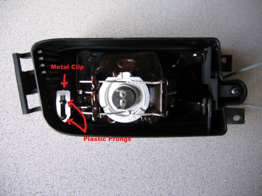

    To remove this deflector shield, open the back of the housing by removing the spring clip and the back side should open up. There is a metal clip that secures two plastic prongs that hold the fog lamp reflector on the outer edge. Remove this metal clip; just pull it off. Use a set of pliers and gently spread open the two plastic prongs while pulling the fog lamp reflector out.

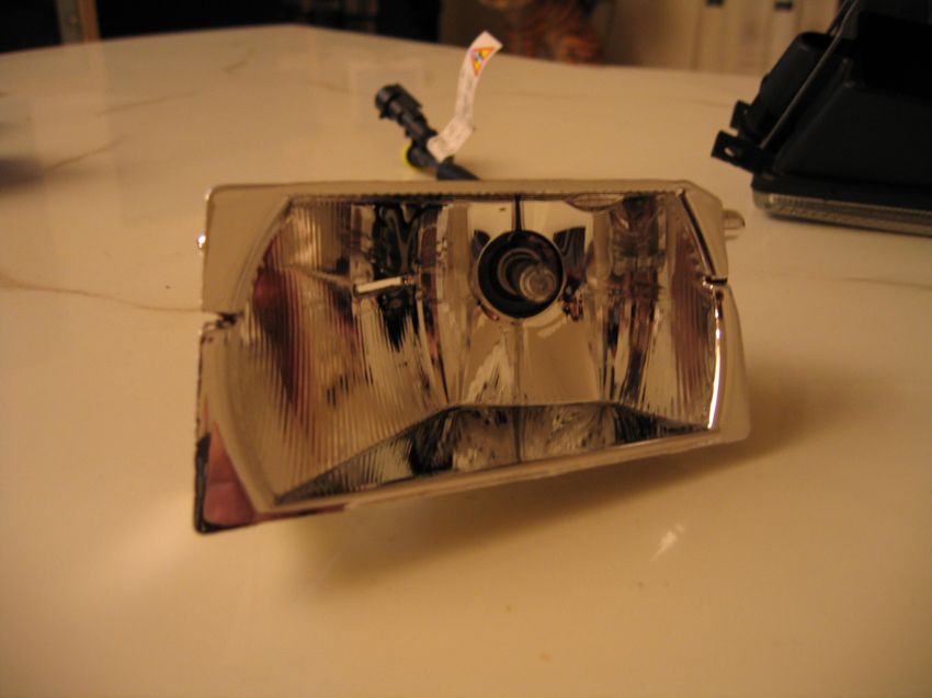

    Next, remove the pin that holds the deflector shield and remove the deflector. Install the fog reflector back into its place and secure the metal clip back on. Now there will be plenty of room for a H7 HID bulb. Here is a picture of the reflector without the deflection shield:

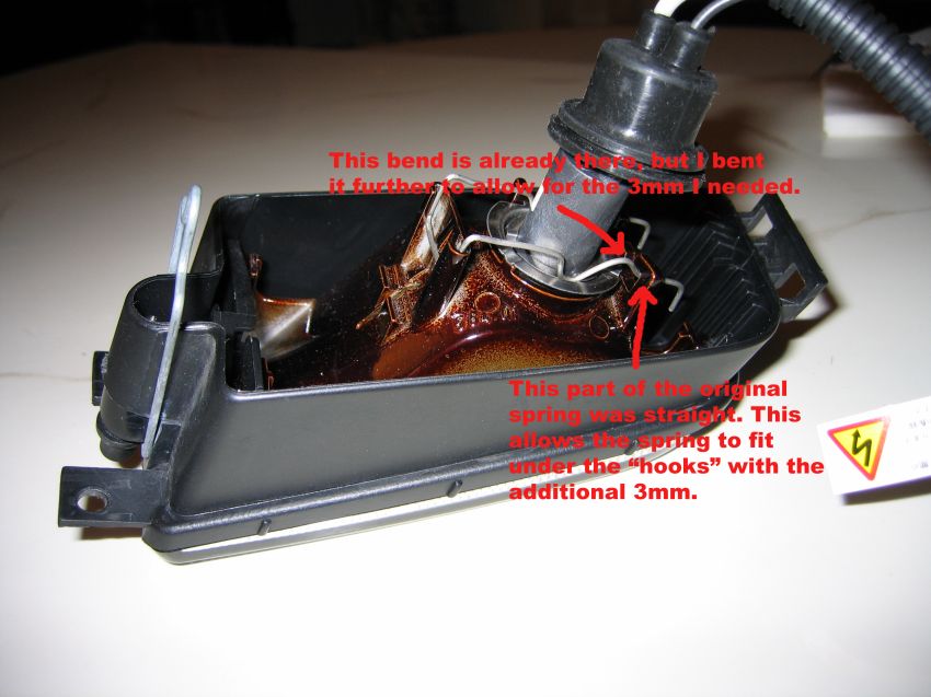

    The standard halogen H7 bulb has a round base and on the back side is a groove where the spring clips hold the bulb in place. The HID H7 bulbs I got with the XTec HID kit had a groove that was 3mm too shallow. When I tried to force the spring clip to hold the HID H7 bulb, it popped right off. With some finess, I suppose you could get the spring to hold. But then you'd have to worry if a bump in the road might pop it off again or if the extra tension might cause enough stress to break something.
    To solve this, I decided to bend the springs in two places on each side to accommodate the extra 3mm clearance the HID bulbs needed. You can see where I bent the springs with pliers in this picture:

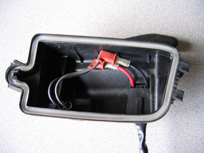

    The XTec HID ballast has standard 9006 female connectors for power input. The standard H7 halogen bulb uses 2 electrical tabs. The XTec kit comes with a wiring harness that takes the electrical tabs on one end and a 9006 male connector on the other end. While this is simple plug-n-play for doing most headlights, the fog lights have a 2 pin electrical plug that connects to the fog lamp housing. On the inside of the housing these wires connect to the actual H7 halogen bulb via electrical tabs.
    My first thought was that I'd have to cut the 2 pin plug off, solder those to the harness that came in the XTec kit to convert into a 9006 male connector. However, I don't like cutting into the factory wiring. And although I could always reconnect to factory 2 pin connector, there would be signs of tampering. Replacing the entire wire seemed too much of a pain.

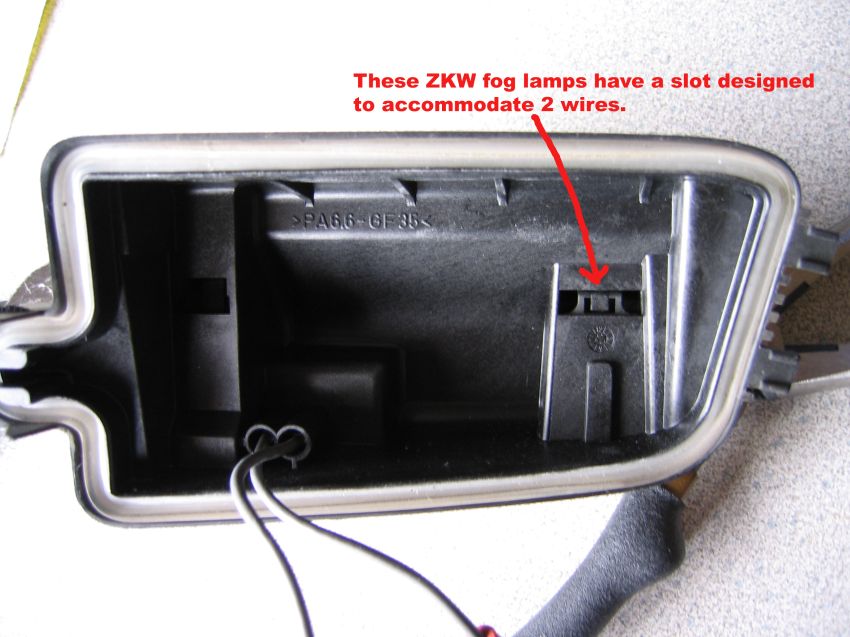

    However, as I took a closer look at the back cover of the fog lamp housing, I noticed that ZKW (the maker of these fog lamps) had designed a slot where two wires could be routed into the housing:

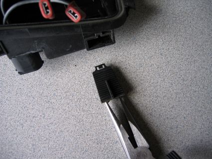

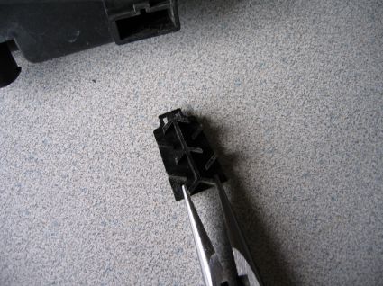

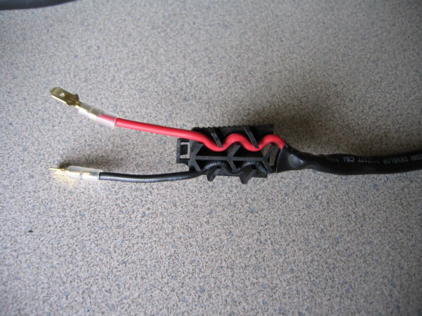

    There is a plastic wire guide piece that you can pull out from the bottom. Turn it around, and you'll see a zig-zag pattern for routing the two wires from the XTec H7 to 9006 harness. Here are pictures of the wire guide being pulled from the bottom and its backside:
    A picture of the wires from the XTec harness being routed in the guide:

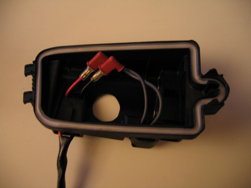

    Once the two wires are inside, connect them to the two wires that normally connect to the H7 halogen bulb. This is where you have to make sure that the black wire from the XTec harness goes to ground (BMW typically uses brown) as the two wires inside the housing are the same grey color. Halogen bulbs aren't polarity sensitive, but the HID ballast likely are sensitive to polarity so it is safest to make sure ground goes to the black wire.
    This way of doing the wiring allows you to use the factory 2 pin electrical plug which you plug back into the fog lamp housing. Plug the wire that comes out from the bottom of the housing which has the 9006 connector to the HID ballast. There is no cutting of any wires here.

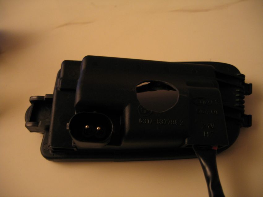

    <li>Drilling holes for the HID H7 bulb
    The HID H7 bulb is much longer than the halogen H7. To accommodate this and to allow the HID bulb's wires to come out of the fog lamp housing to be powered by the HID ballast, you're going to have to drill a hole in the back cover. (These cost $25 to replace if you ever want to revert back to stock. BMW P/N 63-17-8-381-975 (Left) & 63-17-8-381-976 (Right))
    This is where I used my dremel tool. I started by using a drill bit at the center of where I thought the hole would center. Using that hole has a pilot, I then used a hole grinder bit and enlarged the hole until I got it just right. There was a few cycles of "grinding, fitting, grinding, fitting,..." Once I was done, this is what it looked like:
    Once the holes were done, I re-assembled the fog lamp housing with the HID H7 bulb and wiring. Now it's ready for plug-n-play:

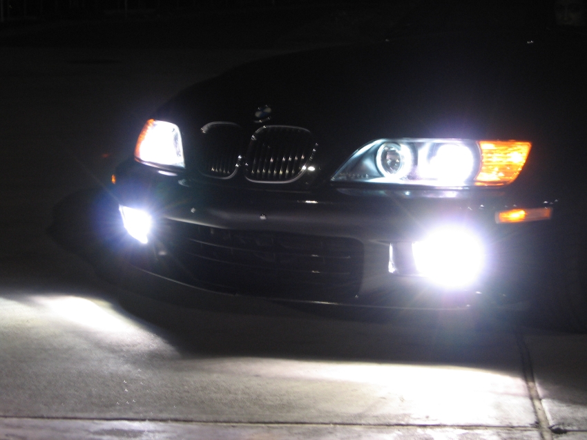

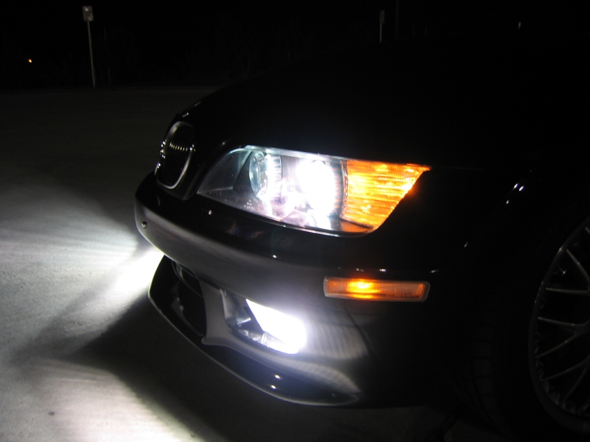

    What's the fun of doing any modification without a before and after? So, here is a picture of when I had halogen H7 fogs:

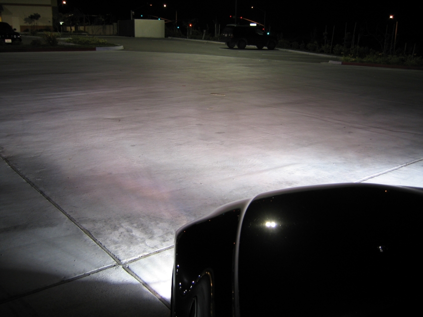

    Here is a picture of the new XTec H7 35w HID @ 4500K:
    And more pictures...
    Enjoy!...

    Regarding glare, i actually try to be a courteous driver; i've been blinded by SUVs with HID kits improperly aimed too many times, I wouldn't want others to have the same experience.
    Halogen reflectors aren't ideally suited for HID lights in general. Halogen reflectors have a much wider range and with the uniform brightness of HIDs, you really have to aim low (lower than w/ halogens) to avoid glare on other people. This is hard to do correctly with headlights since you still want to see what's in front of you. I was comfortable doing HID on the headlights because I already have the ProjectorZ lenses. As for the fog lamps, you can see they are aimed 3-4 inches on the ground forward of my bumper, so the glare isn't so much an issue. I stood about 30 feet in front of the car kneeled down looking straight at them, and it was okay; so I feel they are aimed low enough not to bother someone driving in front of me. Well, not that SUV/Truck drivers ever notice other people driving around them....
