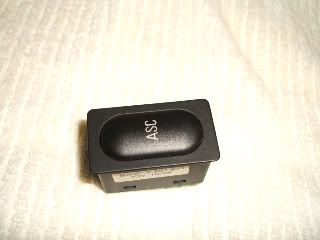

    Actually, there is a ASC button available in the facelifted style. I have one at home. I'll check the # of pins on the back - thinking now that its 4....

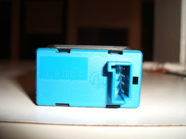

    The post-facelift button is also 4-pin -CONFIRMED
    The PN on the one I have is: 8 381 971 (not sure the part-group prefix for switches, but I'm sure you can find out on RealOEM). This particular one also has a build date of 8-6-99 if that helps you at all. I researched pin-outs of this switch when bought it. I am only intending to use it for powering sport mode, so not too detailed, but from my notes, I have the following:
    1- switch
    2 - Ground
    3 - PWR
    4 - switch

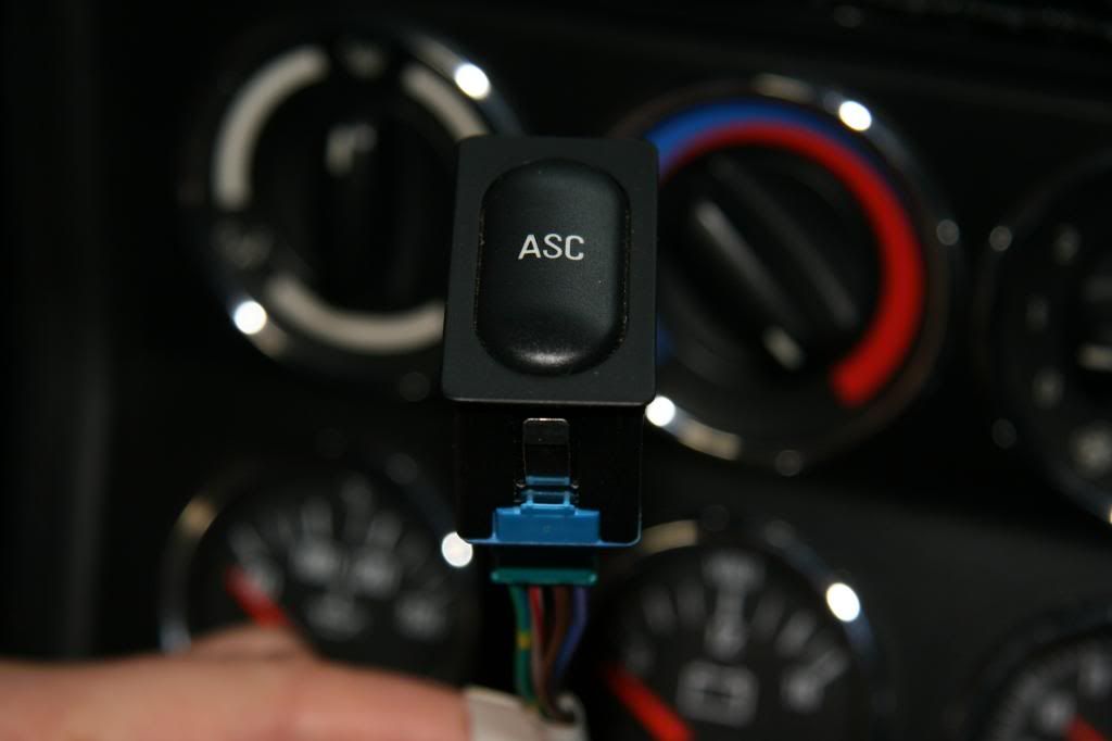

    Also to confirm that a post-facelift ASC switch does exist:
    Quote Originally Posted by Dino D View Post
    Myredzed has made some great posts with pics too about swapping consoles - if he's reading thanks!
    I am reading, thanks for the appreciation

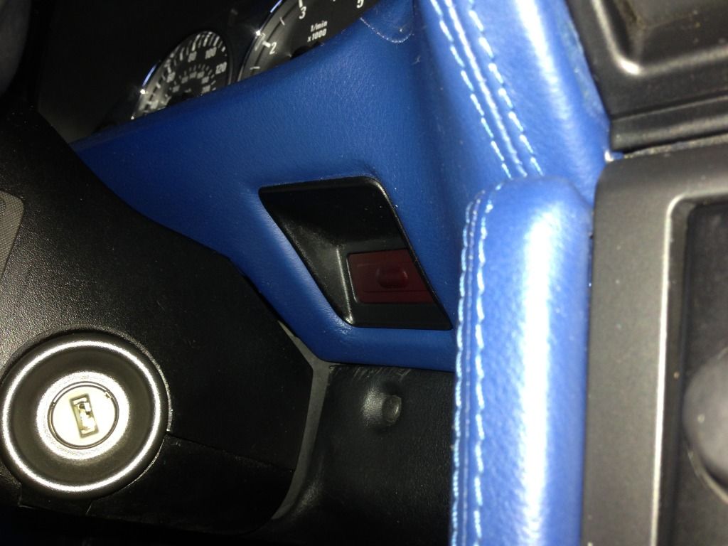

    I have fog light switches next to the ignition so can't go there. I might tuck the ASC switch in the side of the boomerang until I can get a proper facelift ASC switch.
    Now have to find the time to do it all!

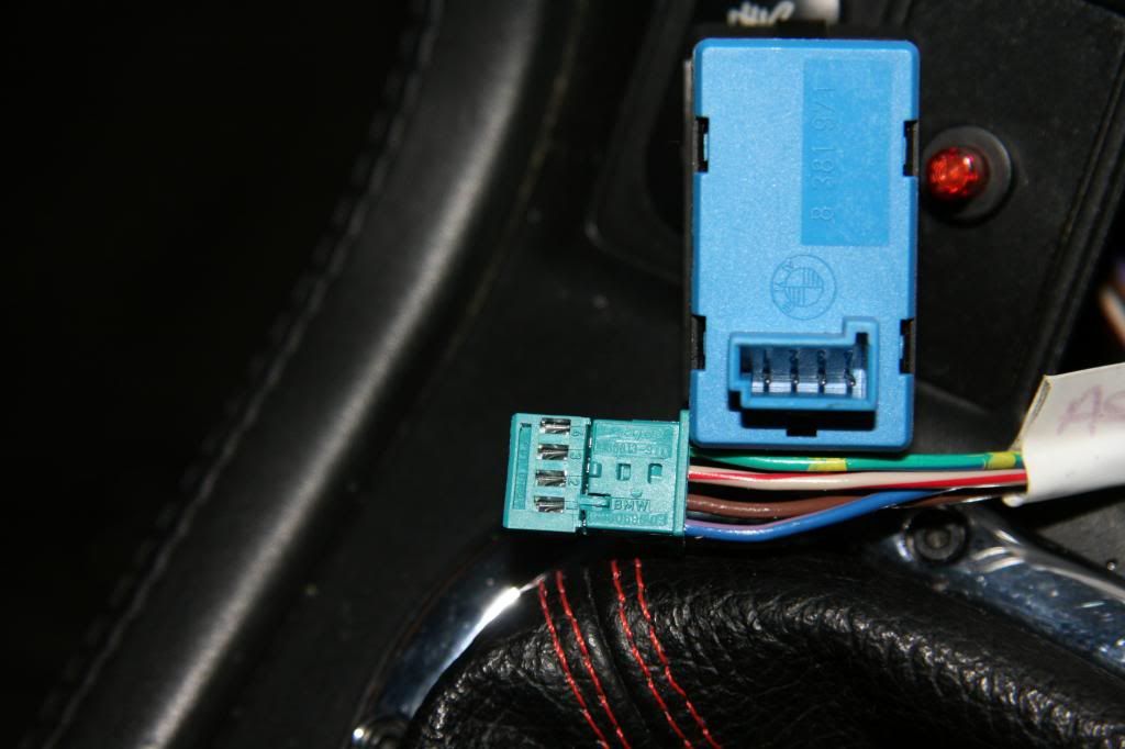

    As promised some pictures for going from pre-facelift ASC switch to post-facelift ASC switch:
    Pre-facelift ASC switch and connector at the top, post-facelift ASC switch at the bottom:
    Post-facelift ASC connector wired in to pre-facelift ASC loom (rather conveniently the contacts on the wires from the pre-facelift connector slot right into the post-facelift connector - no new cutting or terminating required, you just have to get each wire with the contact still on it out of the pre-facelift connector and push each one into its new position on the post-facelift connector )
    Post-facelift ASC switch connected:
    Simple!
