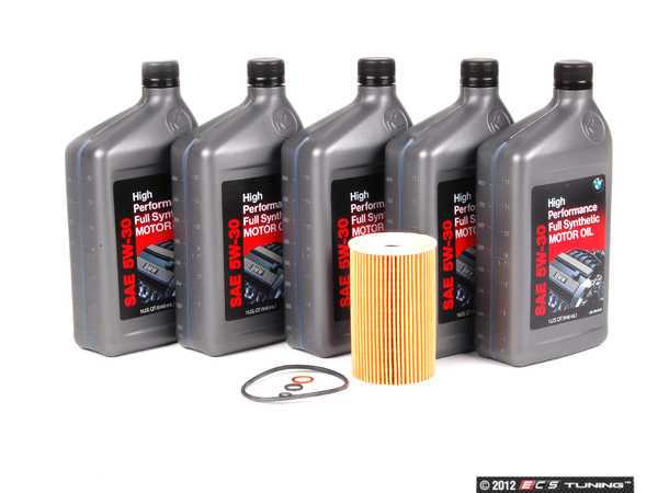

    Is there a post that shows EXACTLY what parts needed to change the oil on a 96 1.9?
    Gaskets, crush rings etc.
    Also what is the general consensus on going over to Synthetic at 130,000 miles

    Just this oil filter kit like the picture below:
    On my 1.9 w/108k miles - I use Mobil1 Synthetic 5w/30

    Do you recommend to replace the filler plug, and is there a crush ring?

    No you should be fine with reusing the old plug...just replace the crush ring...everything you need comes in the oil filter kit....You will need a tool to take off the oil filter housing cap...dunno what size it is but you can pick one up at advance or from bavauto.....dont over tighten the drain plug...I did this once and had to swap the oil pan.....also do not overtighten the oil filter housing...its plastic and it will break...(also had to replace)
    54760 is the part number for the filter wrench over at bavauto...its a life saver
    Yes on Synthetic...its never too late

    All you need is everything in the kit found HERE

    buy the Mann oil filter and it will come with the right crush washer and gaskets. Buy the oil filter wrench from Bavauto. I bought the one from autozone and it didn't work.
