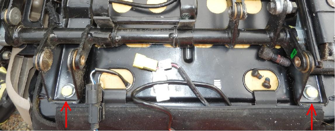

    Looking at the pics I took while working on them the last time: I suspect it doesn't matter, ie, there's enough clearance to get a socket and ratchet in there either way - though for the record, from the pics, it looks like I had the seats all the way rearward when I pulled them.
    The one on the left was missing its head. There are two matching bolts at the front of the seat.

    Quote Originally Posted by gmushial View Post
    Excellent...thank you! I feel confident now that I know what I'll be looking for!
    It would be interesting to know how many with "rocking" seats have met the same fate as my Z, ie, customer (in this case prev owner) goes to mechanic and says the seats are sliding around; the mechanic, not a Z mechanic and knowing nothing about bushings etc, assumes that means that the seat (mounting) bolts are lose, and wanks on them... to the point of torquing the heads off them [actually in two stages: customer tells mechanic that the seats are lose, mechanic "tightens" the bolts, or finds them already tight, gives the car back to the customer saying he fixed them, the customer comes back and says the seats are still lose, so the mechanic really "tightens" the bolts, torquing off the head of one or more]. That's the only way I can imagine the head got torqued off one of the bolts on the driver's seat. [and actually, the rocking and sliding, was one of the reasons that the PO sold the Z - the mechanic after "tightening" the seat bolts, told her that the only answer was a new set of seats, ka-ching, $2000... at that point she gave up and I bought it for a song.] The other four Z owners in town that I'm friendly with - not a one knew anything about seat bushings, but very much knew about the sliding; and likewise sadly, didn't know about the popping welds of the trunk floor. My impression is that there a those (few) mechanics that know/understand Z's, and then there are the rest.
    Good point. Can you confirm that there are only 2 bolts (the 2 rear bolts illustrated above) to be tightened? Or is there another pair in the front side of the seat? I ask because I'm going to try to raise the seat as high as it goes and attempt to tighten them without removing the seat from the car. It seems like this should be possible.

    Fantastic gmushial! Great picture that will probably help solve my rocking issue. I'm putting in a set of Whalens over Christmas and will tighten the bolts down while I'm at it. Maybe even a dab of Loc Tite

    Quote Originally Posted by MCoupeStud View Post
    Only two bolts on the rear. The front is held down by stamped in hooks on the slide rails. Over time those will wear slightly and the seat will squeak. That gap would need to be filed with something thin. I used some card paper.

    Bad news - tightening the bolts pictured above didn't solve anything for me. I just got back from doing it. Basically I was able to move the seat forward and raise it as high as I could, and I had easy access to the bolts. They were tight already but I gave them another push just to ensure there was no movement. I also verified the 2 nuts and 2 bolts that hold the seat in place to the floor of the car.
    Now I don't really know where to go from here. I verified that the bushings were good over the weekend, and I have ensured that the bolts that prevent rocking are tight. I think these seats just fall apart over time. The play is not bad, but it's enough to bother me if I'm paying attention.
    My driver seat moves a little strange. Instead of rocking evenly, it kinda rocks diagonally a bit...it's almost as if one side is more loose than the other.
