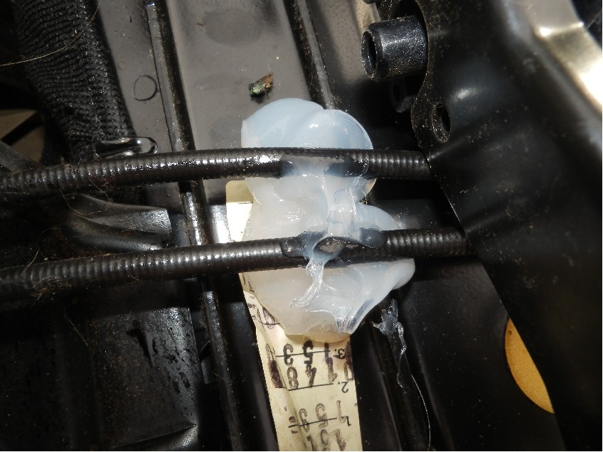

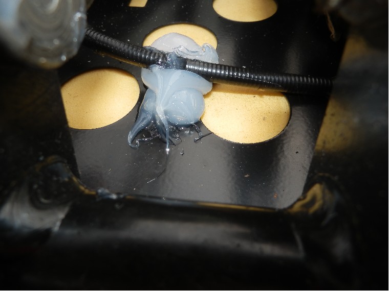

    The high summer temps here do funny things to plastics - some become brittle and crack with zero force, some become turn to goo... it is a quite different world from the moderate weather of coastal NH of my youth.
    The two images below are from the passenger seat that I silenced last week - nope, the globs aren't pretty... but on the otherhand, they are on the bottom of the seats (where I presume nobody will be looking). The single cable would drum against the plastic base of the seat going over any bump or rough piece of road; the other one would likewise rattle but it took a larger bump to do it. Now neither do anything, but sit there quietly.
    W/re goopy messes btwn panels - what I've found is that there are silicone lubes which also contain oil and some that don't: I use the sans oil ones (eg CRC's vs Liquid Wrench's), and have never noticed any residue, either visually or by touch.
    Btw: to provide a sense of scale - the black cable sheath is 1/8" in diam, ie, the largest glop is maybe an inch long; and the smaller one is 3/4", ie, they're not the 4" monsters they might appear to be w/o a scale.
