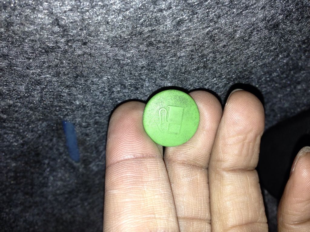

    What does this fuel cord thing do??
    Located on the passenger side of the trunk by the tail light.
    -Phil
    SW Florida
    12,716
    99-01 M Cpe & Rdts, X5M
    If the self-locking mechanism (activates w/door locks) fails, you pull the cord to retract the pin holding the gas filler door.

    I always thought that was fuel shutoff or something
    we had freezing rain a few weeks ago and I thought the door got frozen shut so I lightly pulled on it till it popped open. In doing so I snapped off the plastic peg and just stood there going 'WTF is this thing'

    Just FYI, I discovered that the end of the cord on my E36 can be detached and reattached. No need to cut a hole to remove the trunk lining. I imagine it is the same for the Z3.
