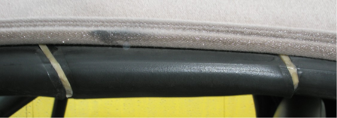

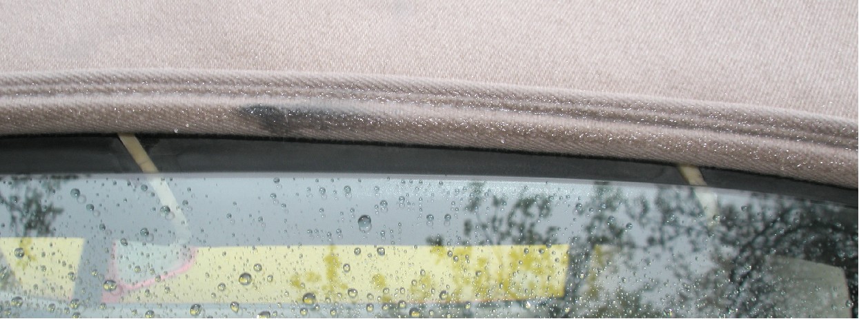

    Following up on my previous post: this water leak cost me two seat motors ($100ish per - the water over the years had rusted the seatrails to the point of seizing and burned out the motors trying to move immovable seats) and seems to have been a problem even for the previous owner. The problem was that the rubber pieces attached to the top [we're talking a '99 Z3 Roady softtop] had developed gaps btwn the three pieces, ie, two gaps, which would allow water to pour in in a downpour. My solution, instead of spending the $160 per three piece rubber set (x2 since this was the case on both sides), was to vulcanize 1/8" neoprene sheet cut in the exact cross-section of the forementioned seals on the end of each. The gaps were probably 80 thou so the 125 thou neoprene is slightly compressed in each gap. I was very careful to shave the added pieces so that they were conformal to the existing rubber, ie, not providing a route in for the water. These picture are from before I took out my marker pen and made the neoprene pieces black to match the bimmer rubber. Now that they're black one, unless they very carefully look, will have trouble noticing/seeing them. [of note: these pictures are quite close in - the neoprene stripes are in fact only 0.080-0.090" wide and not several inches as they may look.] And just a followup: I did a 3k mile road trip two weeks ago, where maybe 2k were in the rain, some in the desert southwest downpour type "rain", and not a drop made it inside the Z.
    With the door open - one can see the crease in the original rubber worn by the window over the years
    with the door closed and the window up, showing the seal btwn the glass and the rubber

    My wife's roady leaks like crazy in a downpour and the under-carpet area is soaked. The elephant noses were clear, I sealed the area around the cowl, and it still leaks. I'm left with the possibility that the front windshield isn't sealed well. That's what I'll investigate next.
    Roadies also have a common leak around the rear seal of the soft-top. This results in a lot of water in the trunk. The fix here is to install the rubber channel that many cars seem to be missing, or seal the channel in place with silicone adhesive.
