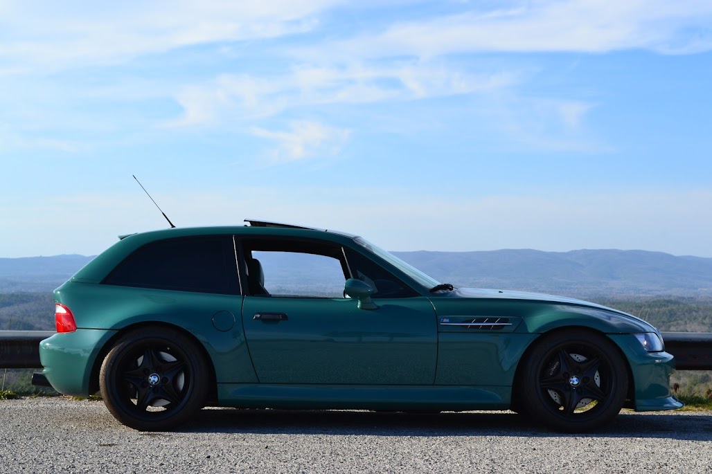

Not the best side shot, but...
19x8.5 ET35 BBF's (Fake BBS) w/ 5mm Spacer
19x9.5 ET37 BBF's (Fake BBS) w/ 15mm Spacer (probably needs a 20mm)
Falken FK-463 225/35/19 and 245/35/19
ST Coilovers
Stuff. I got stuff.
