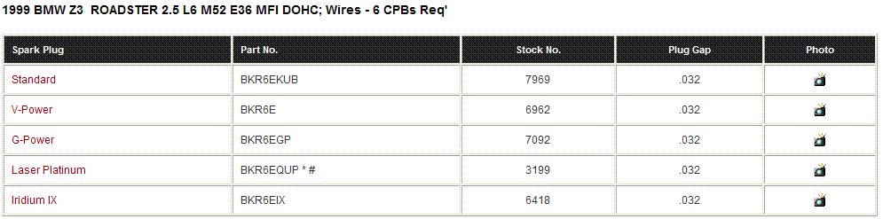

    Yet if one goes to the NGK site... this is what is recommended for at least the '99 2.5L (which includes the EIX)... personally I'm happy with the BKR6EGPs.
    A quick follow up: just got an email back from NGK tech support - seems both the BKR6EGP and the BKR6EIX are 5k plugs. [also seems that most post mid-90's ignition systems are designed around 5k plugs - the 1k plugs date from the 70's and 80's]
    Further follow up: assuming a 10ua (microamp) current through the plug at discharge [haven't found exact numbers in any of my reference material here, nor on the web - all I can find are references to "a few microamps" - so I've used 10 as a safe number] - then the 4k ohm increase (to 5k from 1k) will cause a huge drop at the plug of .... 0.04volts... this is in the context of a 35-45kv system, ie, well buried in the statistical noise.
    A further follow up: I emailed NGK again, explicitly asking if the IX or EGP etc are appropriate plugs for the Z... this is the reply I just received back:
    Hello Greg,
    I think there was some miscommunication. The 1999 Z3 2.5L uses an NGK BKR6EQUP #3199 as the OEM spark plug. The 3199 has a 5K ohm resistor and the BKR6EGP is a suitable replacement for the Z3. I don't know the context of the original statement, but I apologize for the miscommunication of technical information.
    Best Regards,
    Andrew Hauenstein
    Technical Training Specialist
    NGK Spark Plugs USA Inc
    One last follow up: if one plugs into the NGK site all the possible Z years and engine combinations: the 1.9 is different, but all the 6 cylinder engines generate the above table of acceptable plugs.
