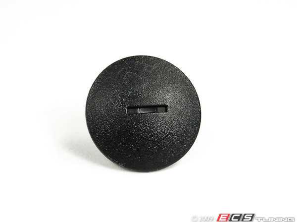

    Specifically i am looking for the nut the holds the reservoir to the car body. The reservoir has an ear w/ hole, the body has a threaded stud. Mine is missing and the dealer can't find it on any catalogue. I looked through realoem.com and also had no luck. Anyone have a pic they could share or better yet, a part number so I could order from the dealer? Thanks..

    It's probably this: 61661368599, but I'm not sure.
    It's not really a nut, it's just a wide-headed thing that pushes onto the stud.

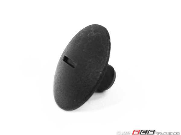

    On mine its a black plastic piece. There are no part numbers or markings of any kind on it. Its got a 1" round domed top with a flat screwdriver slot. The underside is an internally threaded post that's .5" long.
    You can find what appears to be it on realoem. Its got the part number that Josh posted.
    http://realoem.com/bmw/showparts.do?...50&hg=61&fg=45

    Thanks guys. I've been staring at that on realoem the past few days and you're probably right. I'll go order one from the dealer and find out. Problem with the image is that the "nut" is nowhere near where it is supposed to go.

    it sounds like 61661368599

    Part 61661368599 is the one in the photo below. I have it available HERE

    I'm in the same dilemma. Can anyone confirm that 61661368599 is the correct part?
    I can't remember what it looks like but the pictures from ECS have me doubting that it's the right part.

    I just wanted to follow up and report that 61661368599 is in fact the correct part. I just put it on and no more rattle from the washer fluid reservoir!
