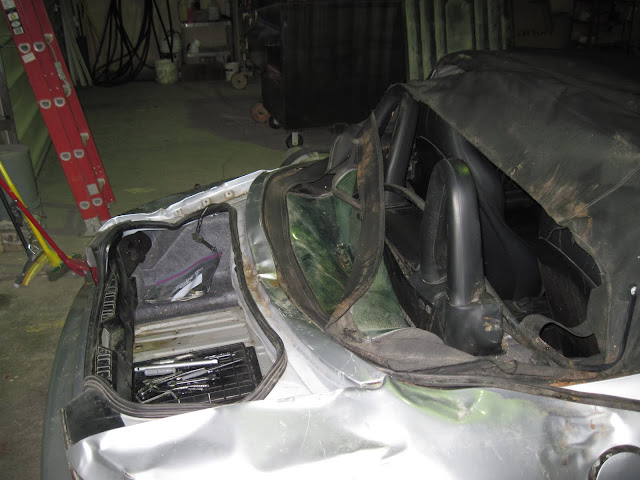

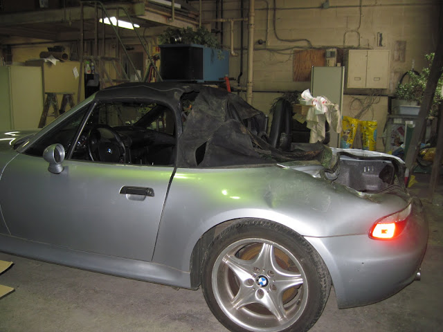

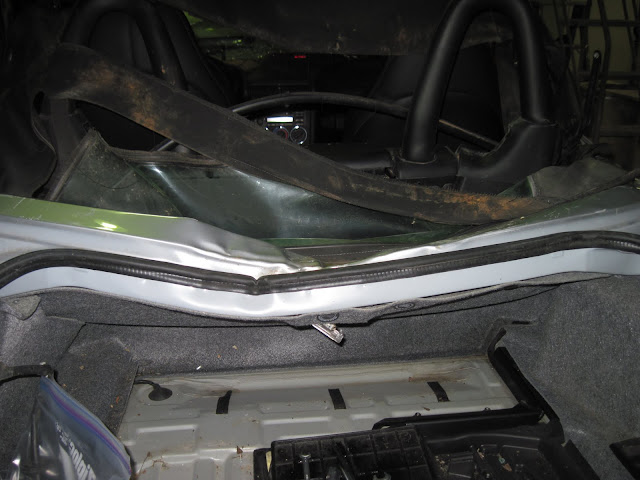

    Finally took some pictures yesterday (remember a tree fell on it):

    The only repair that would scare me I think is the lip of the rag top. I have never looked on mine but if its bent and spot welded it could be hard to get straight again. Your rag top bolts in behind there. I would look into that first, get through that and the rest looks like it could be an easy remove and replace. Best of luck to you, nothing like that satisfaction of diy.

    After seeing those photos I would recommend you prioritize the areas you need that car to be fixed and make sure you keep to a budget of around 5k or so.
    That is if you would rather not dump more money into the car than it's worth.

    have you gotten under it and see if there is any suspension / frame problems? Looks like alot of weight to do that kind of damage.

    I have lined up the rear deck lid, rear fenders, assorted plastic bits, a roll bar, deck lid hinges and struts from a fellow member for a very good price. I have a complete non-M z3 hit in the front at my disposal with a good top. I plan on cutting out the rear sections for the top tub and surround, and welding in the replacements from the donor z3. I may have to section in the shock tower on the passenger's side--don't know yet. Passenger's rear wheel is tilted in a few degrees at the top, so something will have to be addressed there.
    I say "I" will do this, but the truth is I have a very good friend who owns a top notch collision repair shop who will be doing all the frame and body work. I will do all mechanical and coach work.
    The donor z3 is in another good friend's import salvage yard down the street. We'll bring the donor to the shop and dismantle it there and send back what we don't use.
    Cost will come in at less than 5K including the car. That being said, I am giving the car to my body shop friend--I already have one--and he deserves one too. So, cost to me is the whole car, but I get the pleasure and satisfaction of saving one, and the fun of fixing it
