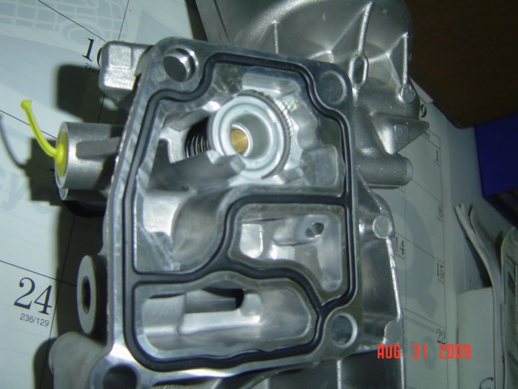

    People say it has one, I assume it does from how reasonably quickly a s54's oil heats up.

    Search the track forum for pics of the t-stat.
    Its clearly visible on the interior of the engine side of the filter housing. Not a servicable part because it does not fail.
    Turner and others sell a t-stat delete kit to maximize flow for race motors.
